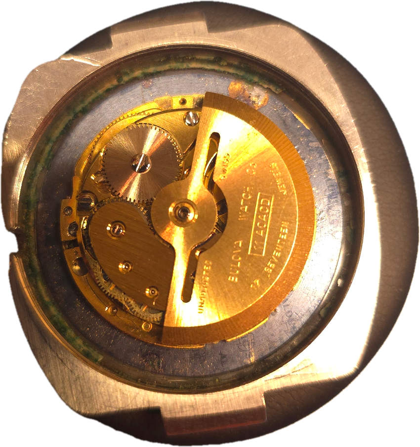

New to the forum, but it has already been very informative.  Recently I acquired a vintage Bulova Automatic, that this forum helped identify, 1976 Bulova 11543-6W, case# 7691, mvmt# 17j 11 AOACD.  I’m the son of a watchmaker, although not my profession, I always watched and learned, so I’m an avid home hobbyist that can tackle most things.  This watch came with a cracked crystal, but was mainly only noticeable by me.  I decided to replace the crystal and sourced the matching OEM Bulova one, 7687 FL.  It does have the flange on the back, so I am confident it is not a front loader.  I proceeded to do what needs to be done for the crystal swap.  I didn’t remove the crown and stem, although I’m not sure I needed to as there is a channel for it to be left in and still remove the movement.  That being said, I removed the case clamps and then tried to remove the movement ring.  It doesn’t budge and almost seems like it is pressed in.  If anyone has any suggestions I would welcome them.  Thanks all and I look forward to learning more from this forum.  I will attempt to add pics as well.

Definitely looks like it's a back loaded movement, so might just be set very tight inside the case. I've not had any experience with these, but others might have.
Good luck.

Thanks for the response.  It just has me puzzled that I can’t identify anything holding it in.  It’s like Edison said about inventing the light bulb, I’ve found 10,000 ways of how not to do it.  Appreciate the insight.

Well...I have an update for all.  The ring is out.  Became my mission today to solve the problem.  I would love to take credit for it, but being to paranoid about buggering something up, I stopped in at a watchmaker friend of mine when out doing some errands.   He was puzzled and perplexed as well.  He looked under his microscope and couldn't see anything retaining the movement into it, but did notice there was some solder on the tube where it meets the movement ring.  He asked another watchmaker there his opinion and he thought the whole thing was one unit, which turns out it was.  Biggest, baddest movement ring I've ever seen.  So he employed more elbow grease than I and it finally popped out.  Turns out it was essential glued in place by the deposits of sweat, spent bodily cells and who knows what else.  So everything is in the cleaning process now and I'll share photos of the behemoth ring once cleaned up.  If anyone has a G947 crystal gasket or knows the measurements of such it would be a huge help.  I have the G942 case gasket enroute, but hitting dead-ends for the crystal gasket.  Thanks for everyone's help and insight.

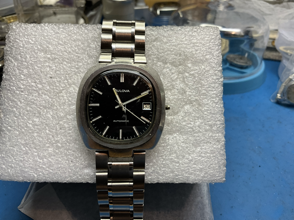

So...a follow up.  I haven't started putting everything together yet as I'm kind of stuck.  I'm in need of a crystal gasket for it, Bulova G947.  I have the caseback gasket, new Bulova crystal and everything else I need, other than the crystal gasket.  There wasn't one on it when I disassembled it, so I have no idea what it even looks like and can't find and information on the G947 gasket either.  The crystal has a flange on it (pics attached), so it's not an "I" gasket and I doubt it is an "L" shaped one either.  If anyone can give me any advice, information or better yet, have one I can purchase from them.  Also, while posting,  if anyone has an end link for this bracelet (pics attached),  I would like to put the original Bulova stainless bracelet back on.  Thanks all!/sites/default/files/uploaded_photos/user26603/13399.jpg/sites/default/files/uploaded_photos/user26603/13406.jpg/sites/default/files/uploaded_photos/user26603/13405.jpg

I have ordered a few times from them and I'm not a fan. Once they took the order and then just ghosted me (but didn't charge me). The other times they were very very slow to respond and then they want payment in, if I'm remembering correctly, Zelle. Which is just weird and not what I would call professional. I did get what I ordered but it took a long time.
I took a look at a few Bulova's of mine that take a flange crystal and the ABC catalog calls for a crystal gasket and none of them had one. The I remembered that I have a NOS Minute Man that takes a 1513FL crystal and according to the ABC catalog should take a G850 gasket. The NOS watch did not have a crystal gasket installed. I have a couple NOS examples of the 11649-W which the ABC catalog also says takes a crystal gasket for the flange crystal but haven't serviced them yet but I'll take a look when I do but I honestly don't think I will find a gasket there.
Here is the SS version of the gold NO Minute Man and you can see if there was a gasket it would go on the underside of the rim of the crystal and sit on top of that ridge (*). The movement ring rests on that ridge. Honestly, it doesn't seem like even if there was a gasket there it would do much to keep water from entering through the front. I know on other watches, like the Golden Clipper 'J', where the ABC catalog calls for a crystal gasket, the gasket came with the NOS crystal. Which makes sense. I would think the same would be true with these flange crystals but none of the NOS flange crystals that I've bought came with a gasket.
