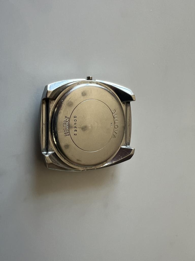

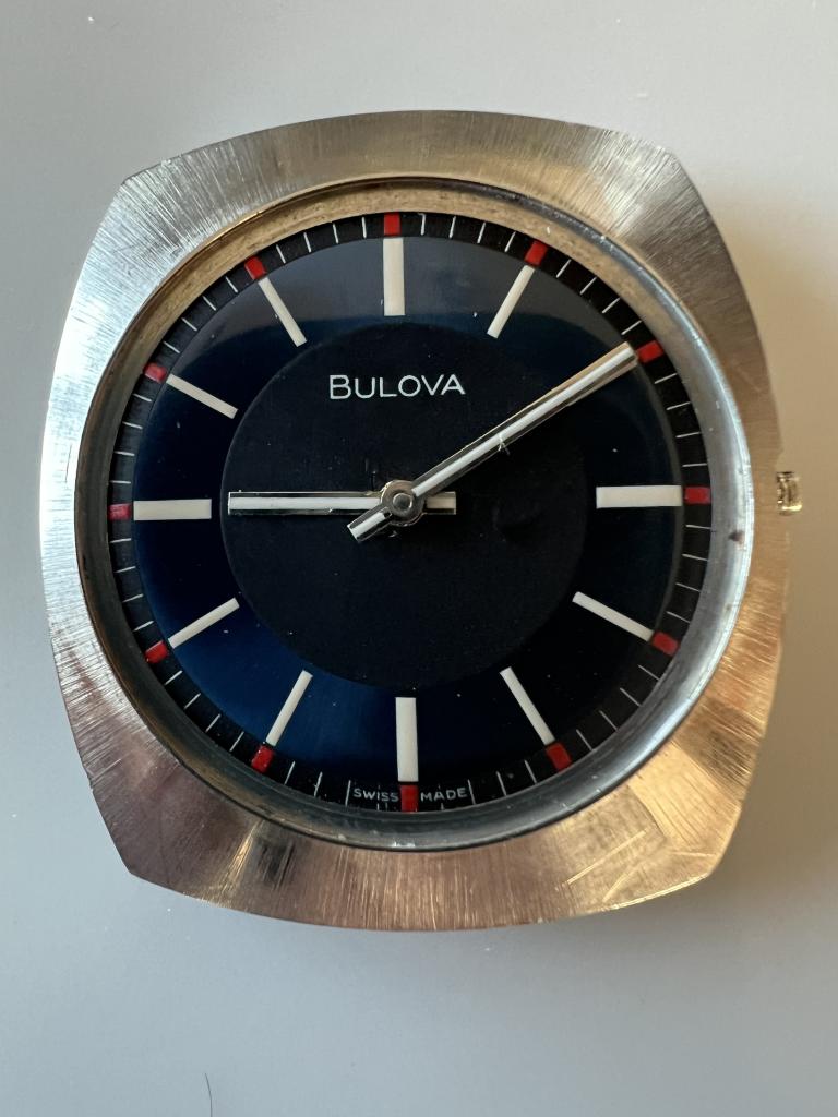

I'm trying to get the movement out of this watch. I think it's a sea king (no whale) N1. I believe it's be a front loader, since the case appears to be just one piece of stainless stell. I took off the crystal with a crystal lifter. Internet research said you need to pull out the stem and it's a split stem. I yanked and it came out but it didn't seem to be a split stem--what came out was a regular stem. So I may have done some damage taking it out. Uh oh. Anyway, how do you get the movement out of this? It doesn't just pop out the top. Bulova made this kind of difficult, didn't they? Thanks!
Andersok
Posted September 28, 2025 - 4:48pm
In reply to by mesadowski
That dial does not comes out the front of the watch. This case has a snap on back. Look for a small opening where the back meets the case - this allows for a sharp tool/blade to access and pry off the back.
The stem is also not a two-piece type. Be sure to check your setting lever to make sure it isn't broken when your stem was forced out.
mesadowski
Posted September 28, 2025 - 5:16pm
In reply to by Andersok
Here is the back. Yes, now I'm thinking the back is supposed to open. But it's fuzed shut. Maybe decades of dirt? I try to open it with an exacto knife but I've had no luck. I put some rubbing alcohol around the seam, but nothing. It looks like someone before me had a similar issue. Someone else left all kinds of gouge marks around what I believe to be the seam.
Andersok
Posted September 28, 2025 - 5:55pm
It is often rather hard to find the opening, but there should be a small curved opening, sometimes on the left or right side. You may need something stronger than an exacto knife.
