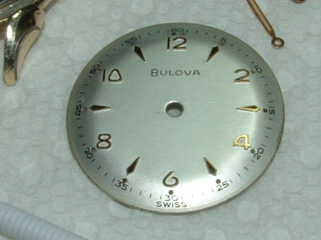

I picked up this 1955 Watertite?? at a local auction with a bunch of others, nice case, great running, but had a real ugly dial and well worn crystal.
I tried glass cleaner, soapy water and could not get the gunk off. The better half suggested I add a little white vinegar to hot soapy water, so I did and like magic it lifted it right off!
The solution recipe is half a shot glass of hot water, 3 drops of dawn liquid soap, and 2 cap fulls of White vinegar, mix it up and use a q-tip to apply, keeping it wet and gently scrubbing it with a microbrush www.microbrush.com  (don't drink the leftover!) ; )
Now to oil it, reassemble, and post it!

WOW, that is a great job!.  Easily done with household ingredients (and eco-friendly, too).  Going to try this myself tonight, I have a lot of faces that need a good cleaning.

It seemed to work well with this one, maybe because the clearcoat was still in good shape? I don't know what was on this dial, but it was not dissolved by plain soap and water or glass cleaner. I plan on trying it on some older ( 40's) dials that are a bit dirty.
I would recommend using those microbrushes, ( $1.99 for a pack of 10 at your local hobby store) it seems that they work better than a q-tip and they don't catch on the applied markers.

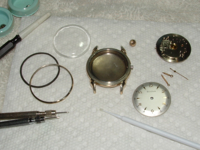

Any chance you can post a pic of one of those brushes??
OldTicker
Posted November 13, 2011 - 10:36am
In reply to by shooter144
Chris,
The bottom photo has one just below the dial, it is the super fine size. Click on the link I provided for more sizes.

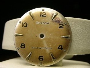

Well I tried this mix on this dial and it didn't clean anything off so I guess it works on some but not all dials.
