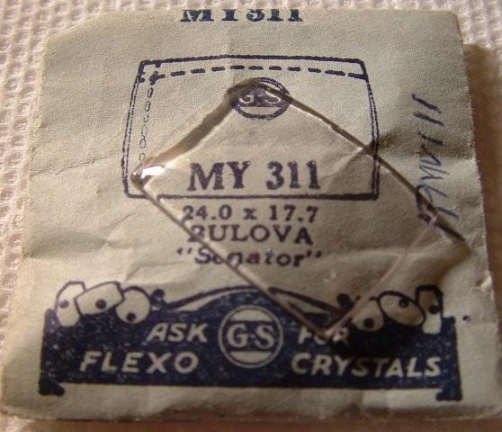

Both the CMY 311 and MY 311 measure 24.0mm X 17.7mm, they are both curved slightly both ways to fit the bezel. The difference is that the CMY 311 is domed and the MY 311 is the standard flat style. Both will work, it just depends on what kind of look you want.
These are GS (Germanow-Simon) part numbers that I have and they are acrylic not glass.
Scott from watchcrystals.net (see ad on home page) should have what you need at a better price.
