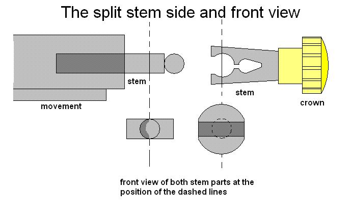

GVP
Posted March 10, 2011 - 7:34am
In reply to by shooter144
 Shooter
The waterproof ones that have the movement removed from the front usually have split stems similar to the picture below, a bit like a key and key hole. You do not bneed to remove the crown. Simpy pull out to time set positing and  you may get a glimpse of it with a loupe, turn it so you can see the slots and then pull the movement out..
Posted March 10, 2011 - 7:52am
If the Dial and Movement come out through the face (waterproof case) the Stem is 2 piece, or should be. Pull to set position, turn back slightly and pul, it should come apart.

Thanx to all, the diagram from GJ is what it is, came apart easily.
