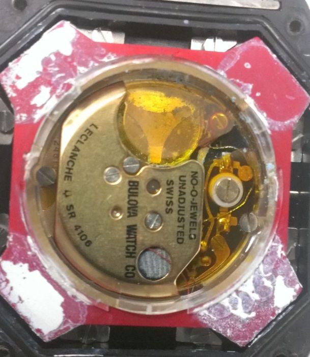

The back lists SR 4106 Leclanche as the correct battery.

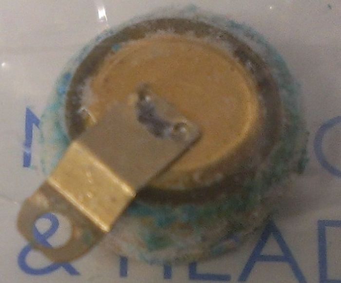

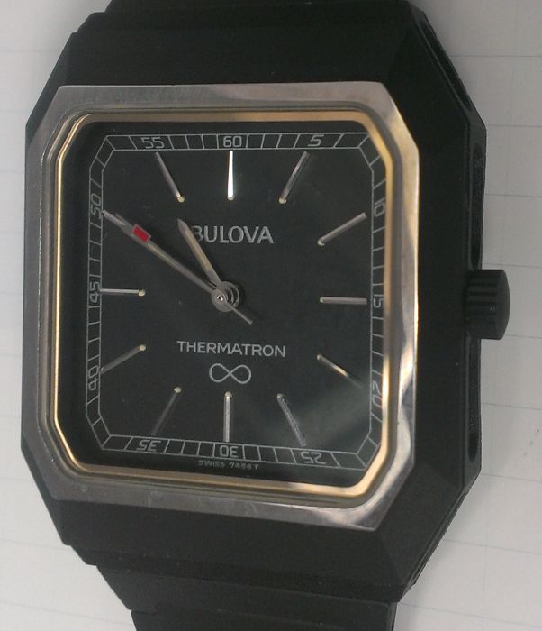

I have attached photos of the watch and the battery - sorry about the poor focus - it is inside a plastic bag.

Despite its modern sounding name, this is not a typical SR battery, it is a capacitor, no longer available. You can substitute a v6HR Accucell with spacer. Here is a link with pertinent info:
http://www.crazywatches.pl/bulova-2467-thermatron-1982

Hi, Many thanks for the information. I am not sure that this was a capacitor.  My reading of the watch's history was that Bulova fitted a rechargable battery, but when the lot were sold to STW they fitted the capacitor as an upgrade. I will get one of the alternatives you mentioned and see if my watch actually works. It was NOS and still has the hang tag with the price (1695 somethings ??USD??) so I do not yet know if it works. As for the movement, I have attached a photo of mine.
Some of the wiring for the battery tab is poorly done as it is just flying leads and very thin and fragile. I have yet to pull it any further apart to clean it up some more.

You mentioned very fine wires, this is a problem even today with most quartz watches, I see careless battery replacement destroying a high percentage of watches.

I love how the 25, 30 and 35 are upside down when viewing the watch normally. Interesting watch and worth while keeping a record of it in this forum.
