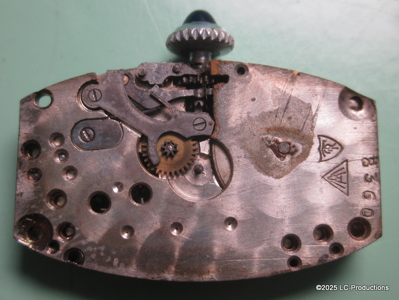

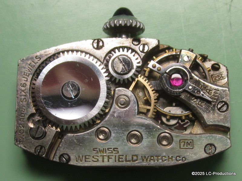

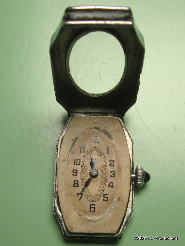

Here is a Westfield watch I just finished cleaning up (pictures are pre-cleaning). Note it has an A. Michel movement. There are some adverts to be found at https://www.watchophilia.com/general-information/westfield/. This movement has a strange  (to me) design of the end stone and regulator arm which I have never seen before. It was particularly finicky to take apart and reassemble.
 FrontFront case open
